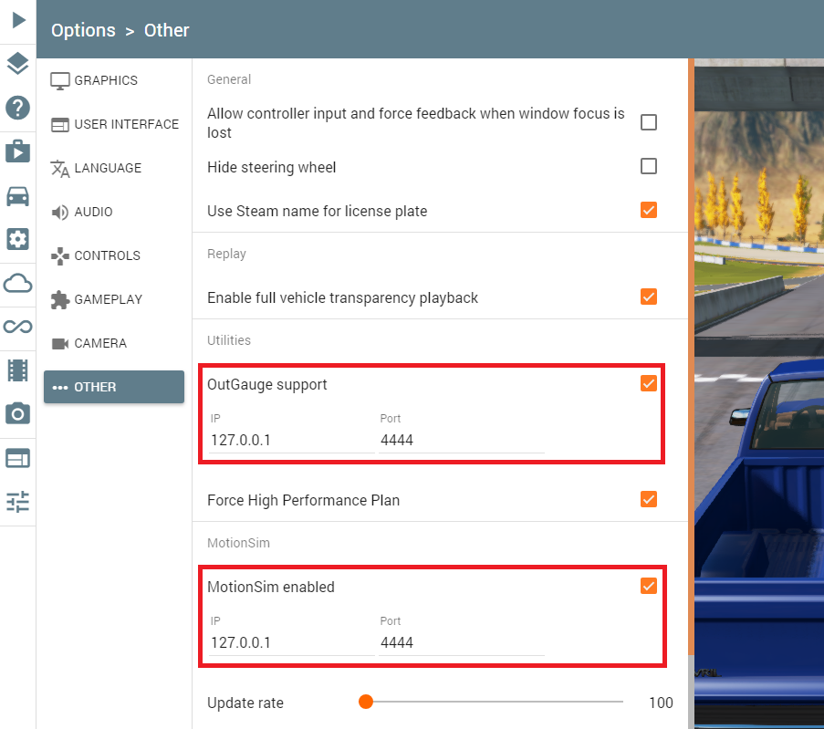

Enable telemetry in settings:
Start BeamNG.drive
Open the OPTIONS
Click OTHER
Enable OutGauge Support
Set OutGauge Port to
4444Enable MotionSim
Set MotionSim Port to
4444Done
