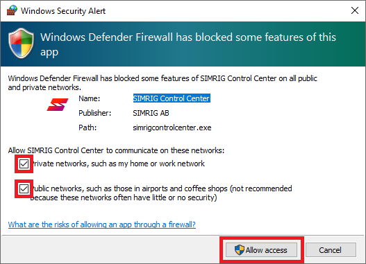

Firewall¶
Make sure to allow SIMRIG Control Center through the Windows Firewall. Many games transmit telemetry over the local network. Network access is required to enable motion in these games.
