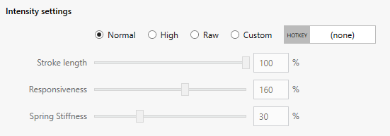

Intensity settings¶
Until this point we have considered settings that affect the range of motion. The intensity settings however affect its speed and acceleration. The speed and acceleration are crucial for the perceived intensity.
Intensity settings affect the linear actuators’ speed, acceleration, and travel. There are three presets to choose from: Normal, High, and Raw, with increasing levels of intensity. The forth option, Custom, allows precise control of each setting.
- Stroke length:
Sets the actuator maximum travel. A value of 100 % allows the actuator to move 70 mm. While a value of 50 % allows for 35 mm of travel. Fast and stiff car’s benefit from lower stroke length.
- Responsiveness:
Sets the actuator power. A lower value results in lower acceleration while a higher values means more power and higher acceleration. Try a lower value if you think the motion system is too fast or too aggressive.
- Spring stiffness:
Sets the actuator compliance to directional changes. Try a lower value to remove high frequency noise and bumps.
Tip
Use the Hotkey to switch between presets without leaving the game.

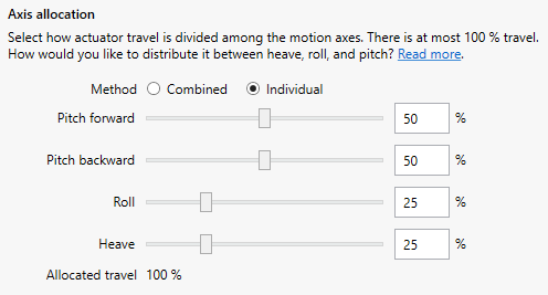

Axis allocation¶
Each linear actuator has a fixed amount of travel. This is determined by the actuator’s mechanical construction. How we choose to use this travel is determined by the Axis Allocation settings.
A fixed amount of travel is allocated for each motion axis (pitch, roll, heave.) For example, we can allocated 20 mm of travel to pitch, 30 mm of travel to roll, and 20 mm of travel to heave. The Allocation Settings determine these amounts.
Interestingly, we could allocate 70 mm travel to both pitch and roll at the same time for a total of 140 mm of combined travel. But! Moving 140 mm is physically impossible. However, the vehicle will seldom brake at full power while also turning at full speed. If it does, the actuator will bottom out, causing the motion to clip. You can choose more motion at the risk of clipping; or less motion and no clipping. This is a compromise that is different for each vehicle.

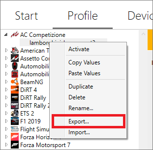

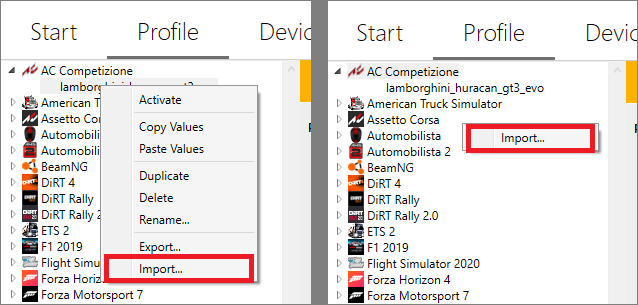

You can export individual profiles to a file. The file can be shared and later imported. Exported profiles have the file extension .scc-profile.
To import a profile, right-click anywhere in the profile tree and choose Import…. Alternatively, drop the file on the profile tree.
To export a profile, right-click the profile to export and choose Export..
